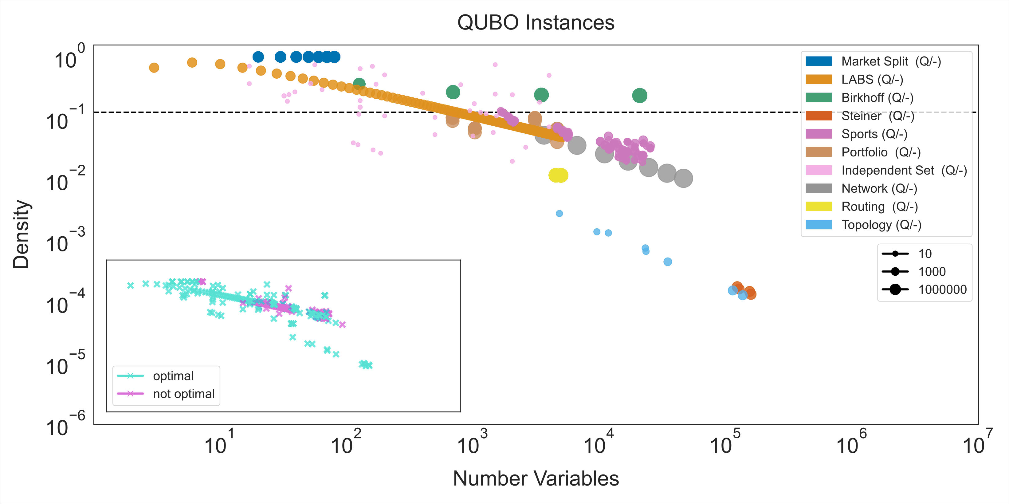

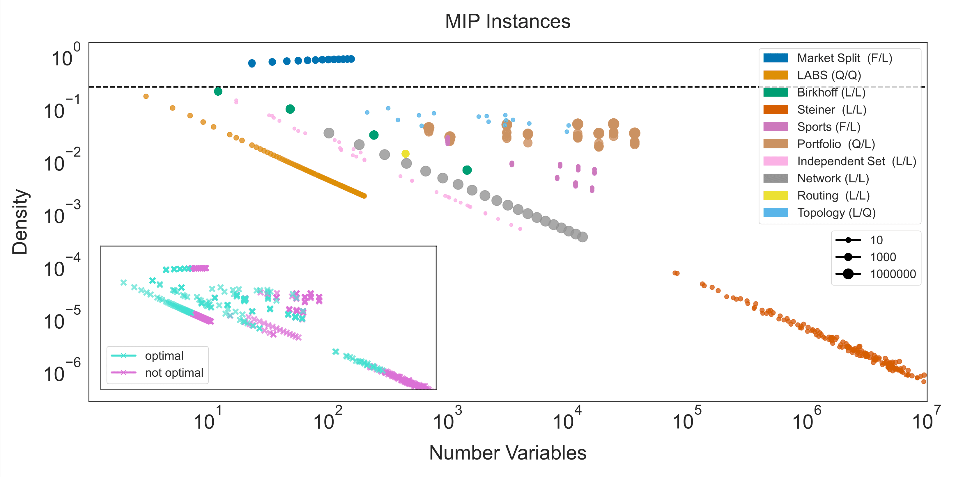

The repository provides access to reference models — both mixed-integer programming (MIP) and quadratic unconstrained binary optimization (QUBO) — which researchers can use in combination with the classical baseline results to analyze the latest quantum algorithms. MIP and QUBO are two different ways of formulating optimization problems — with the MIP formulation often serving as a basic entry point for classical researchers, and QUBO filling the same role for quantum researchers.
Ultimately, we can only demonstrate quantum advantage if we allow researchers to tackle problems in arbitrary ways, and if we do not limit ourselves to particular types of modeling. MIP and QUBO are merely examples of how we can formulate problems, and we make no claims whatsoever about their optimality. Instead, we present them as starting points that researchers can explore and potentially use as inspiration for developing entirely new formulations that may be more amenable to quantum processing, or which may even enable better classical solutions.
In the figures below, you can see how the MIP and QUBO reference models for each problem class change in density as the number of variables increases. It is interesting to note how the process of mapping MIP to QUBO formulations alters the picture. In many cases, this mapping leads to increases in the number of variables, the problem density, and the range of coefficients — all of which contribute to increased model complexity. You can think of these figures as maps of the intractable decathlon, helping you navigate the landscape of problem instances and find the best place to get started.
